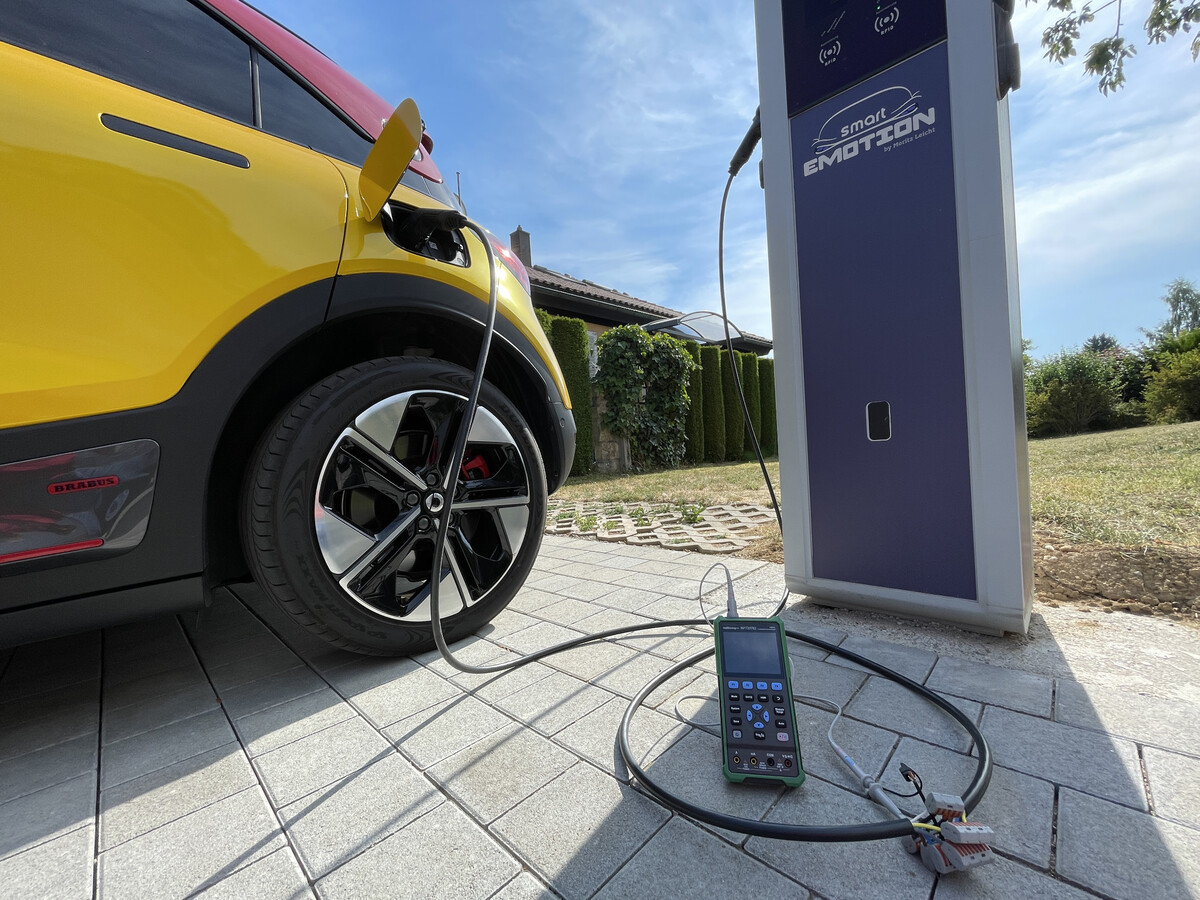

    Do you already know this article?
    How efficient are the on board chargers in the smart #1 and #3? - smart EMOTION
    The smart #1 and #3 have the 22 kW charger as standard from the pro+ line onwards. So even away from the fast charging station they are fully charged after…
    www.smart-emotion.de
    The ac dc converter on the #5 is very likely the same.
